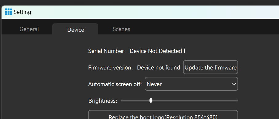

发表于 2025-4-7 17:01:42 | 显示全部楼层 |阅读模式
Hello! I just plugged in my new MiraBox via USB, downloaded the software and it says "Device not detected" and I can not do anything. The device is lit up but no function.... Please help!

发表于 2025-4-8 10:45:38 | 显示全部楼层
Is it effective after replacing the wire?

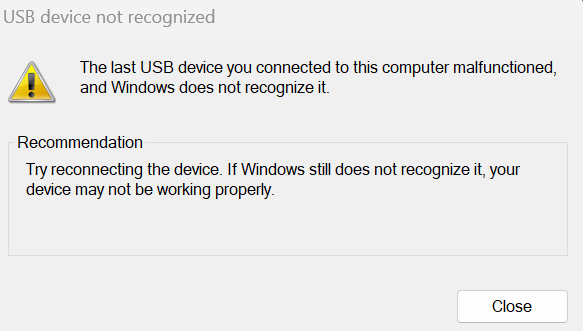

 楼主| 发表于 2025-4-20 16:47:33 | 显示全部楼层
Thanks for getting back! At least I get a recognition now after I changed the cable but getting this notification...

发表于 2025-4-21 11:14:45 | 显示全部楼层
AllFactsCrypto 发表于 2025-4-20 16:47
Thanks for getting back! At least I get a recognition now after I changed the cable but getting this ...
Is your device N4? Open the "Device Manager" on your computer, unplug and plug in our device, and check if there is a refresh. If there is, replace it with a fast charging cable for a phone with more than 33W and try a different USB to see if it works properly

 楼主| 发表于 2025-4-25 08:35:29 | 显示全部楼层
Thanks, changed the cable for a third time and it finally worked! Appreciate your help!

发表于 2025-6-3 02:27:54 | 显示全部楼层
Whether the device works also depends on which USB port it is connected to. If connected to some ports, it may not work - for example, USB ports on a monitor.

发表于 2025-6-3 09:54:51 | 显示全部楼层
Ryszard 发表于 2025-6-3 02:27
Whether the device works also depends on which USB port it is connected to. If connected to some por ...
Because our equipment requires a rated voltage and current to function properly, if the USB cable is too long, it will weaken its strength, resulting in disconnection issues. Additionally, the USB may have poor contact; That's also one of the reasons
