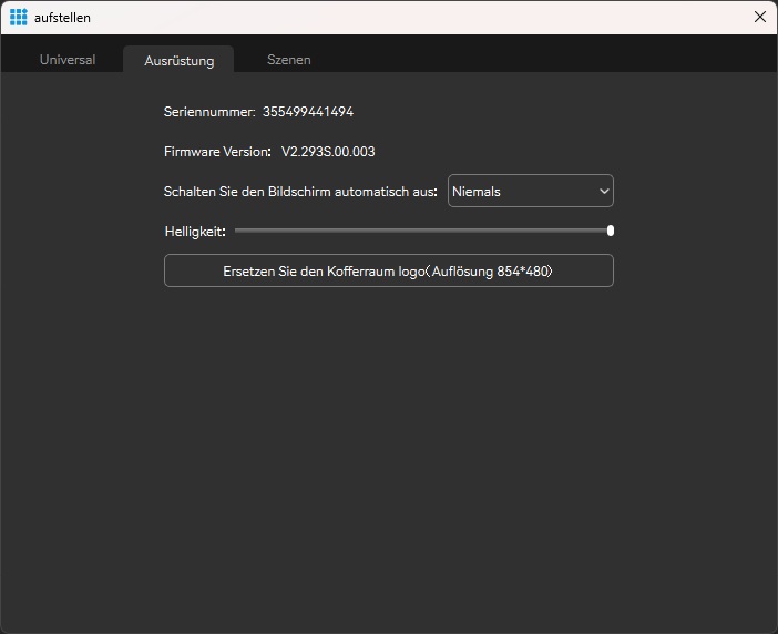

 楼主| 发表于 2025-6-23 22:36:04 | 显示全部楼层
dockkey2023 发表于 2025-5-28 16:53
Can you please check the firmware version numbers of the two devices and send them to us? They sho ...
Both have the same Serial and Firmware
Serial Number 355499441494
Firmware V2.293S.00.003

 楼主| 发表于 2025-6-28 06:32:32 | 显示全部楼层
Beide Steam Decks haben die gleichen Nummern
7
47
47
 楼主| 发表于 2025-7-5 00:35:40 | 显示全部楼层
dockkey2023 发表于 2025-6-26 09:24
After connecting your two devices separately, please take a screenshot of the hardware version num ...
Beide haben die gleiche Version
