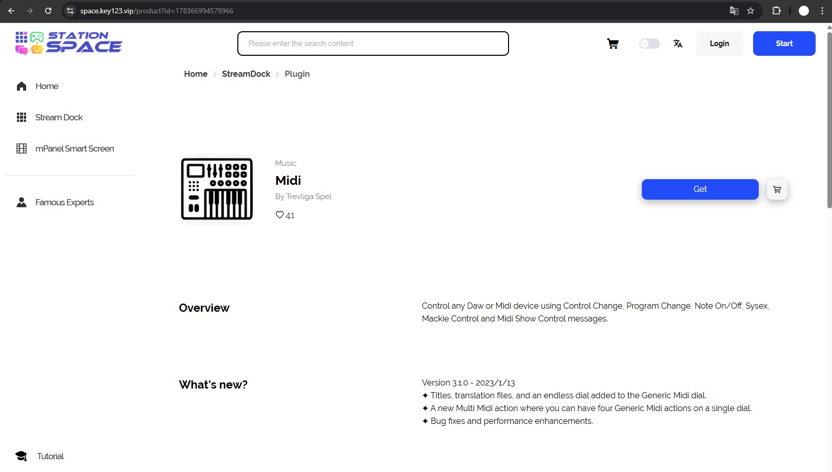

Hello! I am a sound engineer, and I recently purchased the Mbox N4 for my audio work. Overall, the device makes a great impression, and I really like it. However, I’ve encountered an issue that currently renders it completely unusable for me at this stage. I would like to use the MIDI plugin from Trevliga Spel, which, by the way, is available not only in the Elgato plugin store but also in the Mirabox plugin store. Here it is:

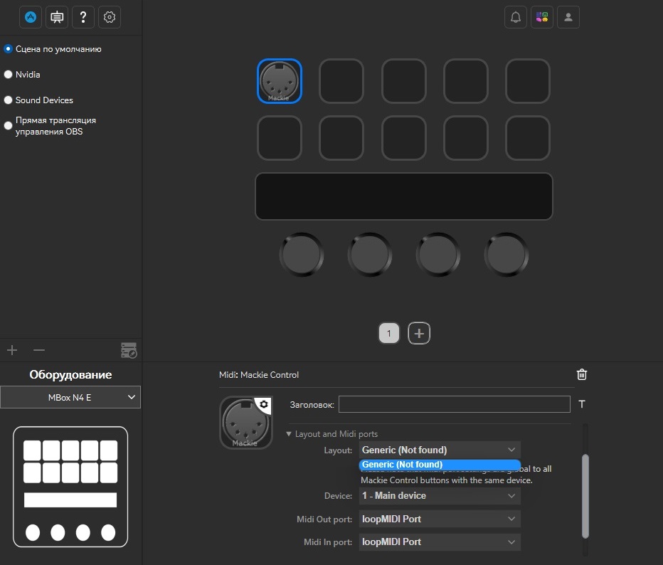

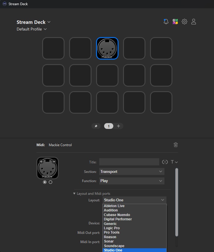

When using Mackie Control within the plugin, you need to select a layout to match the software the plugin will interact with. In the Elgato Stream Deck application, the "Layout" dropdown menu is displayed correctly:
However, when the plugin is installed in the Mirabox Stream Dock application, the dropdown menu contains only one item: "Generic (Not found)." As a result, further configuration of the plugin becomes impossible.
I have already contacted the plugin developer directly, but he informed me that the plugin was created for Elgato, and he is not familiar with Mirabox software and not able to fix the issue. Please make an effort to resolve this on your end. At the moment, this problem effectively prevents sound engineers and sound producers from using Mirabox equipment to control their devices and software via the most common and convenient protocol. Moreover, I believe this issue in your software, which prevents the dropdown menu from being displayed correctly, could negatively impact the user experience of many other plugins as well.

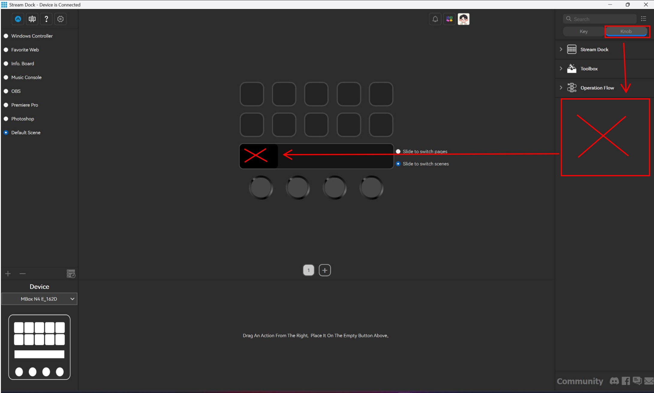

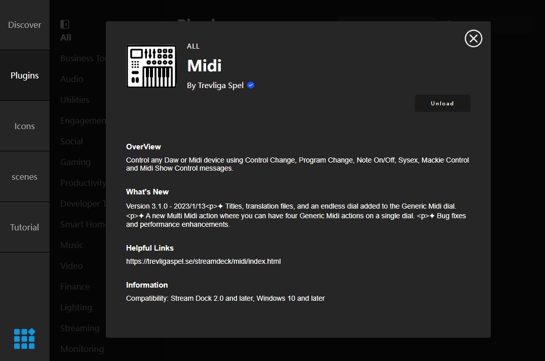

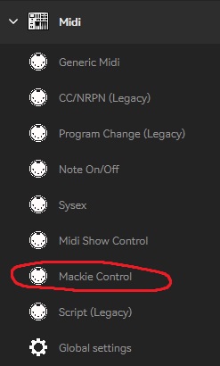

I recently purchased the Mbox N4 for my audio work as well as an alternative to the Elgato Stream Deck, hoping it would offer all the functionalities I need. My main goal is to use the N4 with my DAW and as a midi controller, specifically with the MIDI plugin from Trevliga Spel. However, I’ve been unable to get the knobs to work with the MIDI plugin. I’ve noticed two main issues: first, the MIDI plugin available on the marketplace is outdated. Although I found a workaround by copying the plugin from the Stream Deck plugin installation folder, the dials/knobs of the N4 don’t support the plugin. The plugin doesn't appear on the knob's page. I’d appreciate it, if your engineers could look into this and consider updating the firmware to resolve the issue. I really like the N4, and I believe this is the only missing element. If it were addressed, I’d be happy to recommend the product to my colleagues in the industry.

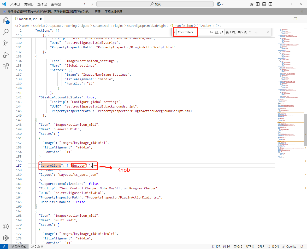

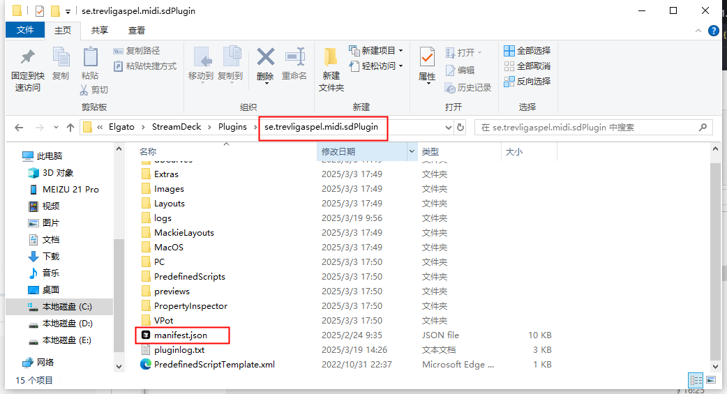

First find this file
Open it and change the all Encoder in "Controllers": [ "Encoder" ] to Knob, then restart the software and you can use it in the knob.
First
First
Encoder to Knob
Encoder to Knob

发表于 2025-3-20 11:32:54 | 显示全部楼层
Open it and change the all Encoder in "Controllers": [ "Encoder" ] to Knob, ...
Very impressive. Are you interested in developing your own plugins? We have instructions for the SDK
8
8
发表于 2025-3-20 21:52:58 | 显示全部楼层
OMG!! thanks a lot Heart. You quickly solved my problem. You are the best . Now my purchase seems complete and totally amazing. Really appreciate your support
