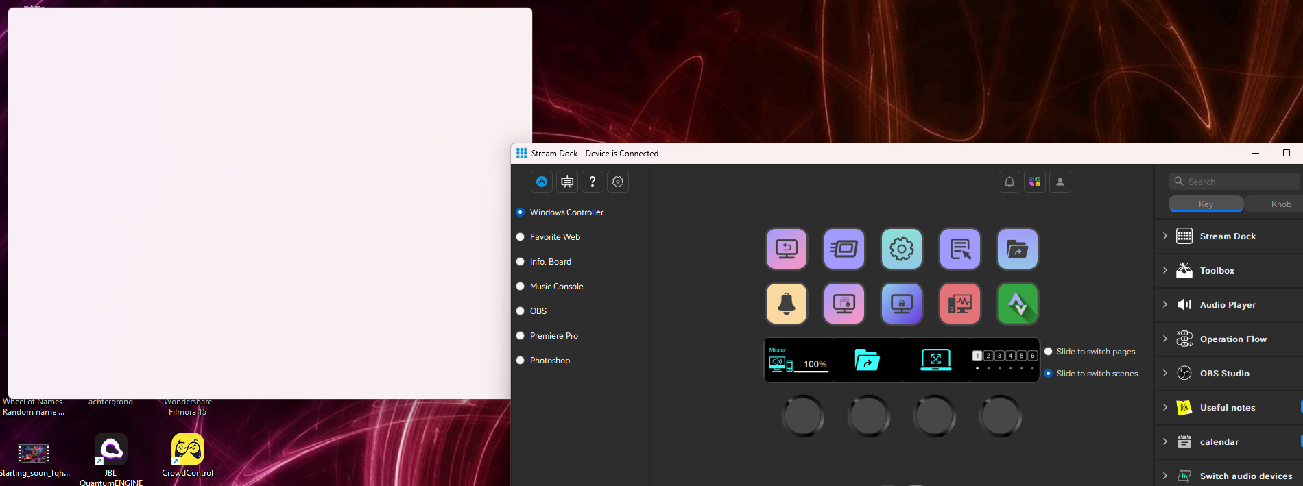

I have a white screan if i turn on the steamdeck N4
and it won`t go away

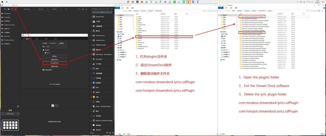

发表于 2026-7-6 09:12:41 | 显示全部楼层
This issue is already being addressed. You should have used a plugin for lyrics. If you delete the plugin "com. miraboux. streamdock. lyrics. sdPlugin" from the "plugins" folder in the settings, you will not see this white box appear

发表于 2026-7-8 10:01:54 | 显示全部楼层
Following this method will resolve the issue
