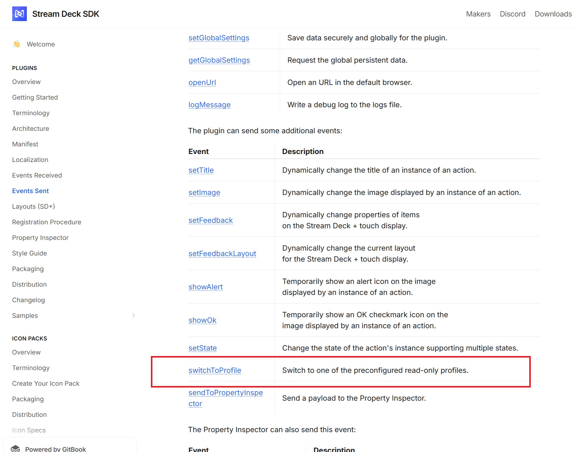

Why doesn't StreamDock SDK allow changing Page and Scene in plugin? Elgato SDK supports switchToProfile events!

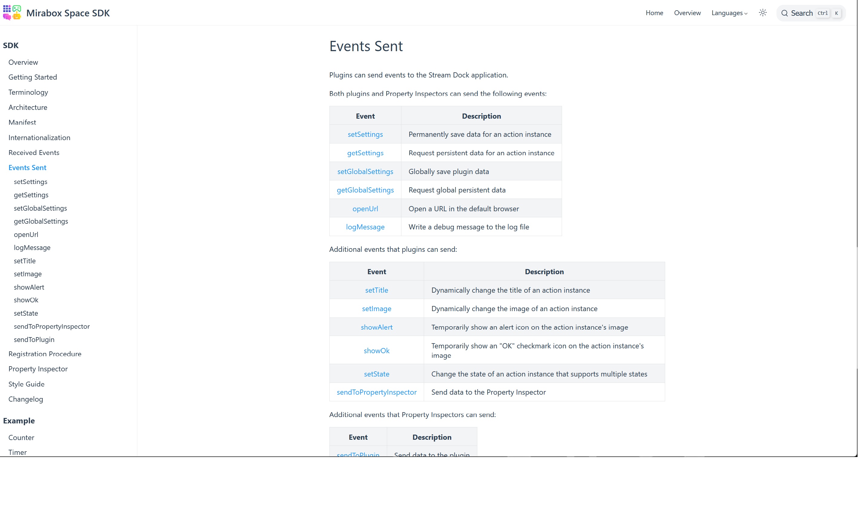

This thread is not about specific existing plugins but about the Mirabox SDK:  https://sdk.key123.vip/en/guide/events-sent.html
An important functionality that is in the Elgato Stream Deck SDK is not implemented in the Mira Box SDK (compare images). I wanted to write a plugin that does what is missing in Stream Dock but I am not able to because the functionality is missing not only in the Stream Dock application but also in the Mirabox SDK (see attachments).

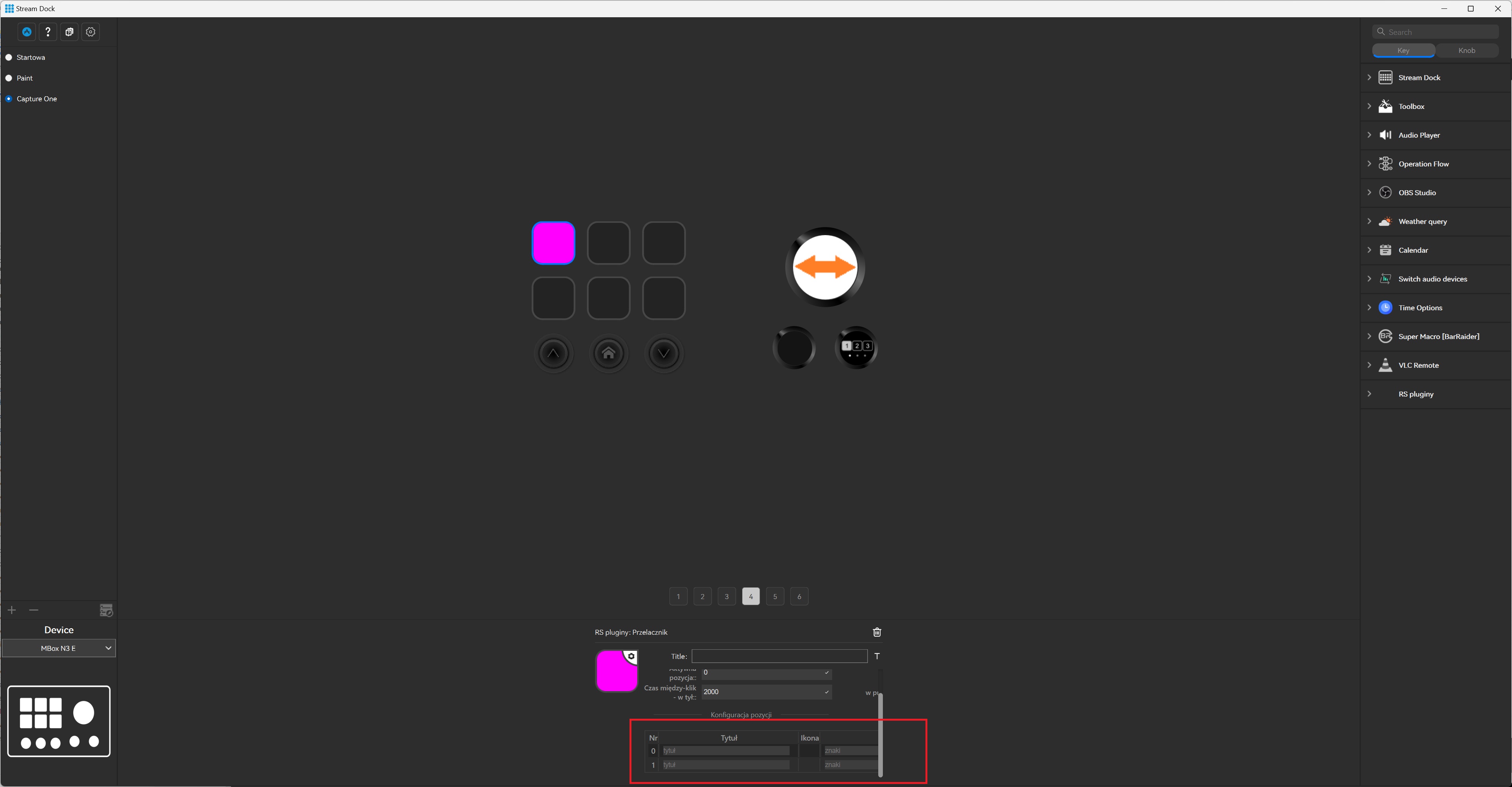

The stram dock application does not scale at all - as you can see in the attached image. Having a large monitor leaves a lot of free space in the middle. Properties do not stretch at all (they adjust to the window - you can see them circled in red at the bottom of the image). There is not even a slider to move the area sideways. In the case of tables - as in the attached image - it is completely illegible.
Why so much empty space around buttons and knobs - this area should adapt to the size and not take up unnecessary space. property should be maximally increased - and adapt to the size of the window, so that data can be easily entered. Here it is currently done incorrectly - exactly the opposite.

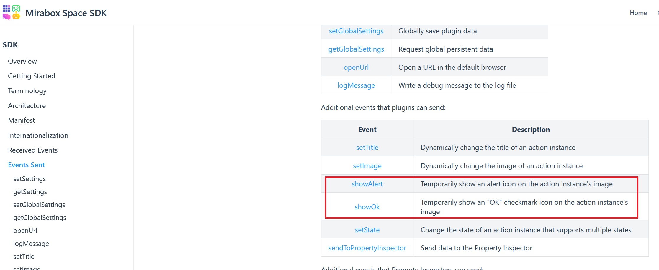

StreamDock does not work according to MiraBox SDK documentation - showOk and showAlert not working.
Of course you can display your own icon but... - it should work according to its own documentation (especially since it does not even contain all the events from the original Elgato SDK).
