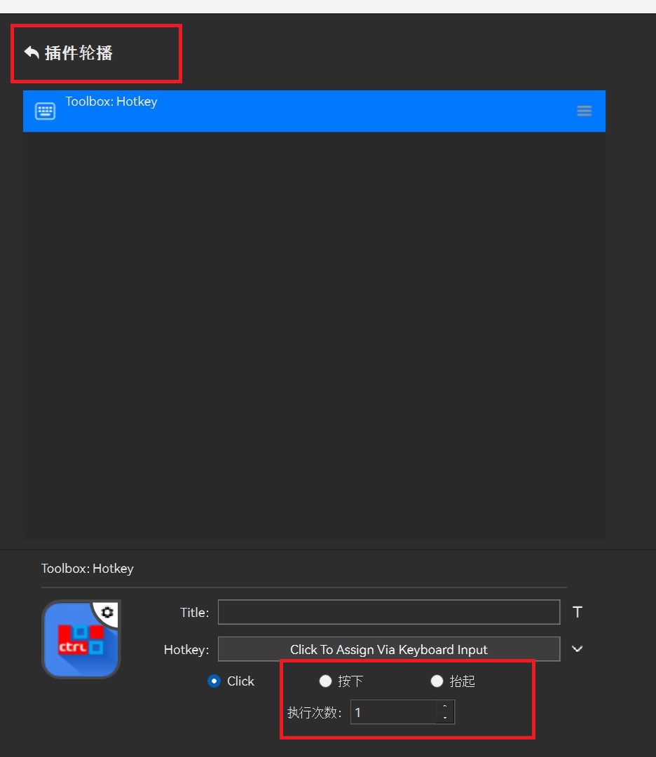

 楼主| 发表于 2024-11-7 01:10:04 | 显示全部楼层
Yes. From the user's point of view, Operation flow (which allows you to perform several actions, one after the other) would also be useful in operating the knobs (both pressing and turning).

发表于 2024-11-9 16:32:02 | 显示全部楼层
Ryszard 发表于 2024-11-7 01:10
Yes. From the user's point of view, Operation flow (which allows you to perform several actions, one ...
Yes, you are already working on the development of this feature

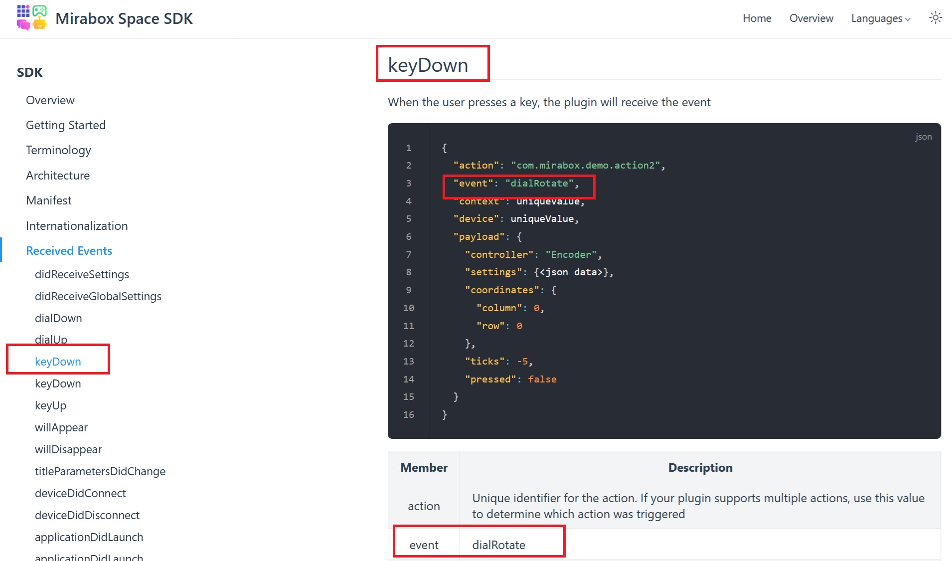

 楼主| 发表于 2024-12-24 21:26:16 | 显示全部楼层
Error in SDK
1826
5740
5740
发表于 2024-12-26 10:03:02 | 显示全部楼层
Thanks for your feedback, we have fixed the error
