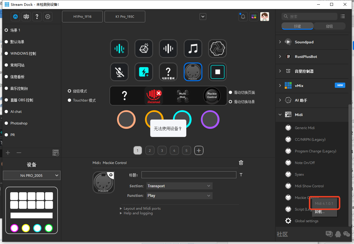

发表于 2026-3-25 19:14:26 | 显示全部楼层
rdoctor 发表于 2026-3-25 06:41
Hello, using Midi 3.1 I changed "Encoder" to "Knob" and Generic Midi is now working for knobs, howev ...
I haven't made any changes; both dropdown lists contain items. I think the problem is caused by our different versions. I downloaded the plugin from here:MIDI Plugin

发表于 2026-3-25 19:15:44 | 显示全部楼层
This is my version.

发表于 2026-3-25 19:18:20 | 显示全部楼层
If your version is different from mine, you can right-click to uninstall the plugin and then download it from here:MIDI Plugin

发表于 2026-3-25 22:26:00 | 显示全部楼层
Ok, your link solved my issue, thank you! However, why is the MIDI plugin on your website different from the one I got from within the VDS Stream Dock software?

发表于 2026-3-27 09:40:22 | 显示全部楼层
rdoctor 发表于 2026-3-25 22:26
Ok, your link solved my issue, thank you! However, why is the MIDI plugin on your website different  ...
Are you saying that the Midi plugin downloaded from the store is different? I have already synchronized and updated the version of Space with the one in the store

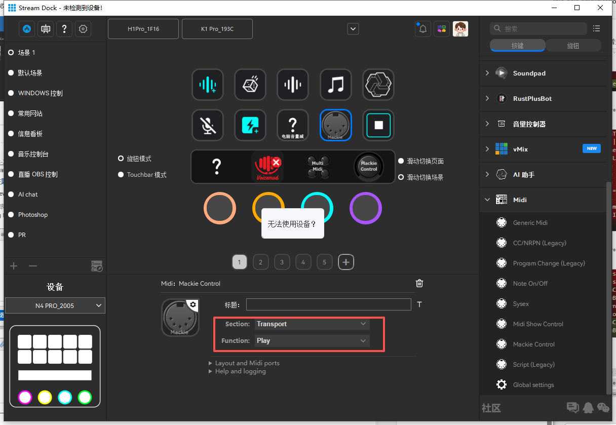

发表于 2026-7-5 02:36:13 | 显示全部楼层
你好,我是使用的 N4 pro,我想做的操作也是想将midi 映射到旋钮上,但是我是 mac,无法做到 Windows 的操作,我的想法是想映射到旋钮上之后,可以根据旋钮的左右转动改变 midi 输出的数值,[/img],如果可以的话,最好是在旋钮按下去的时候这个数值可以回到一个固定的值。

发表于 2026-7-6 09:55:57 | 显示全部楼层
-QinY 发表于 2026-7-5 02:36
你好,我是使用的 N4 pro,我想做的操作也是想将midi 映射到旋钮上,但是我是 mac,无法做到 Windows 的操 ...
可以的,
