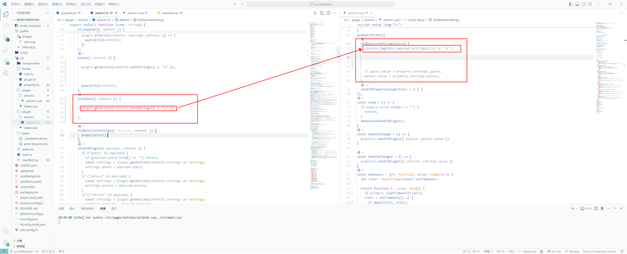

For example
57
215
中级会员
215

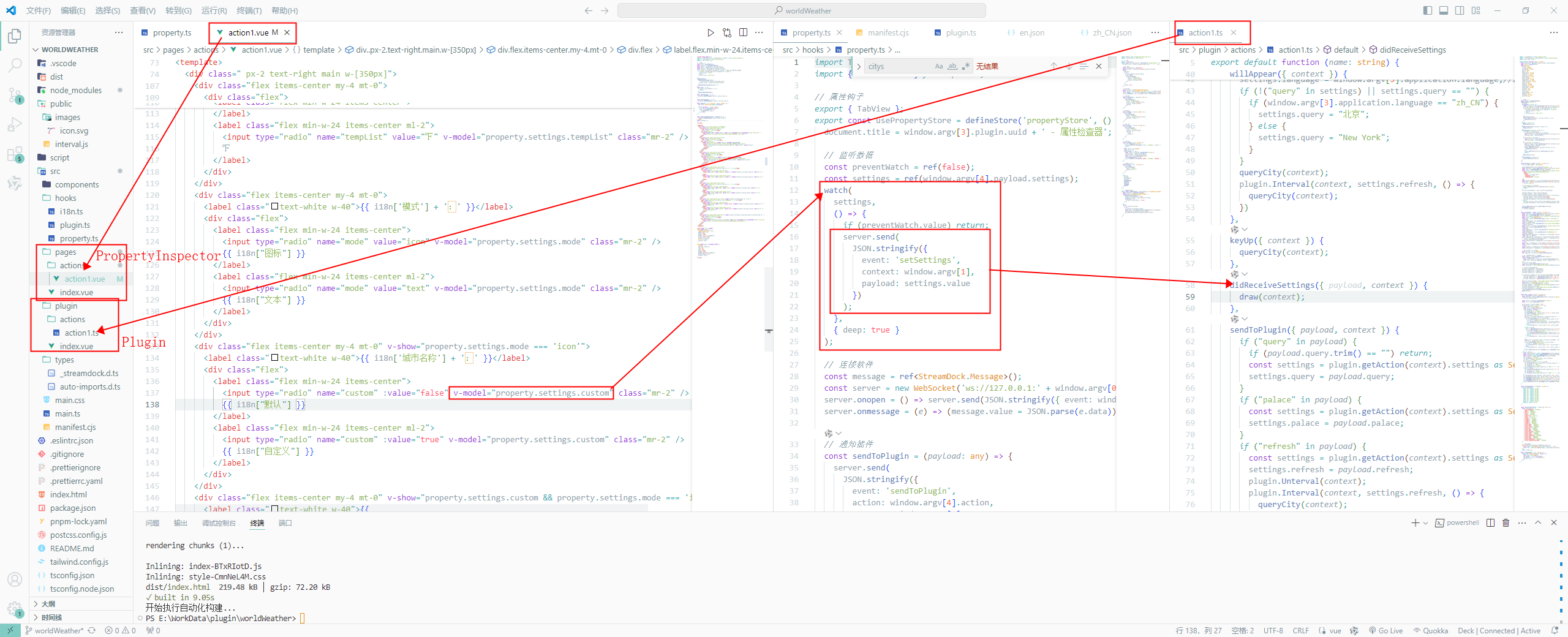

Example 2 Plugin->PropertyInspector
57
215
中级会员
215

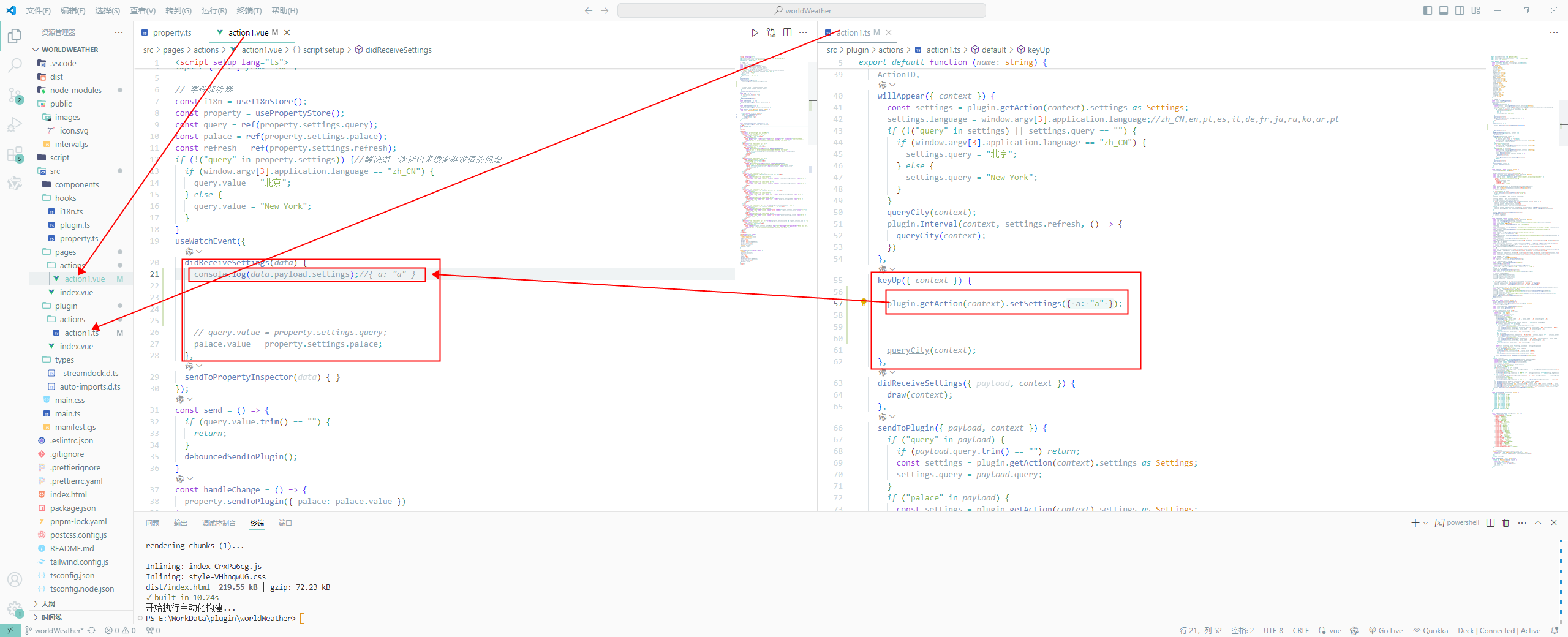

I just found a knob device and tried it.
57
215
中级会员
215
