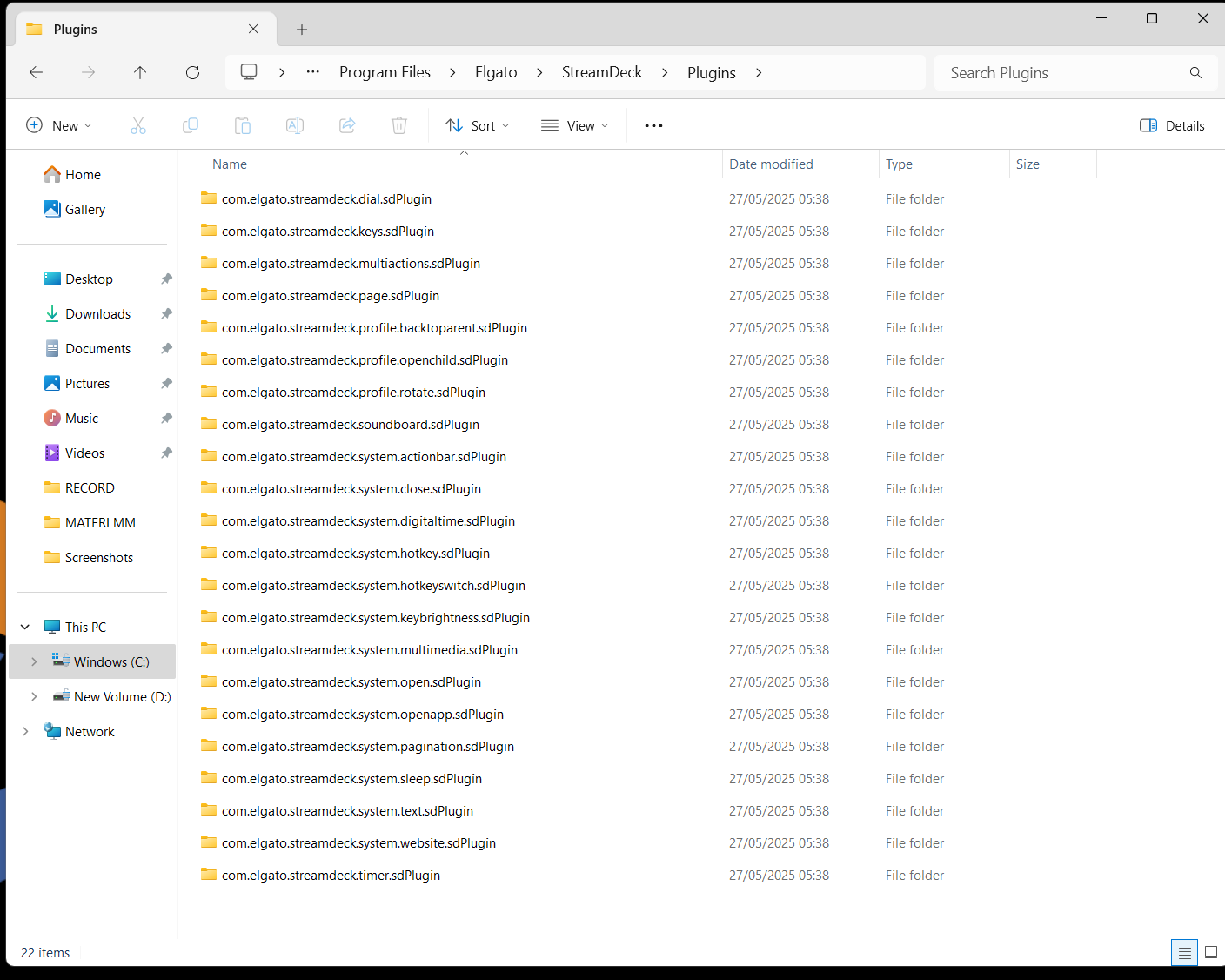

发表于 2025-6-5 21:16:52 | 显示全部楼层
why is there no such file on my laptop
1828
5752
5752
发表于 2025-6-6 09:22:42 | 显示全部楼层
Our software is called StreamDock, not the software name you are currently taking a screenshot of. You can find it in the same folder

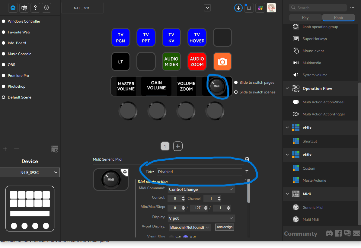

发表于 2025-7-13 16:40:41 | 显示全部楼层
Heart 发表于 2025-3-19 16:56
First find this file
Open it and change the all Encoder in "Controllers": [ "Encoder" ] to Knob, ...
Thanks for your help, it's very helpful, but after this MIDI successfully entered the knob column, the MIDI thumbnail cannot be changed and the text cannot be changed, can you help this. Thanks in advance

发表于 2025-11-12 17:26:00 | 显示全部楼层
dirgamoke 发表于 2025-7-13 16:40
Thanks for your help, it's very helpful, but after this MIDI successfully entered the knob column, ...
I apologize, I didn't notice your message. The inability to modify the title is due to the "UserTitleEnabled": false field in the manifest.json file. Changing it to true and restarting the software will allow you to modify the title. Regarding the image not updating, this is a compatibility issue. Our knob's image settings use a slightly different interface than Elgato's. We will resolve this issue later; for now, the image won't update.
