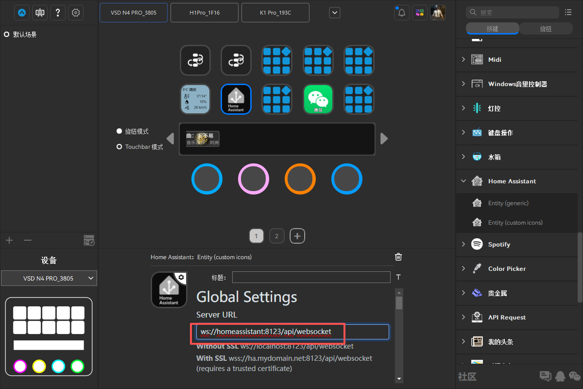

发表于 2025-11-20 10:08:38 | 显示全部楼层 |阅读模式
027585d48a242ea36893e6ab09b45e68.png This is the Server URL. If `homeassistant` doesn't work, try `ws://homeassistant.local:8213/api/websocket`. If that doesn't work either, replace the domain name with the IP address of your HA server, for example: `ws://192.168.0.1:8213/api/websocket` (this IP is just an example; you should replace it with your actual HA server's IP).

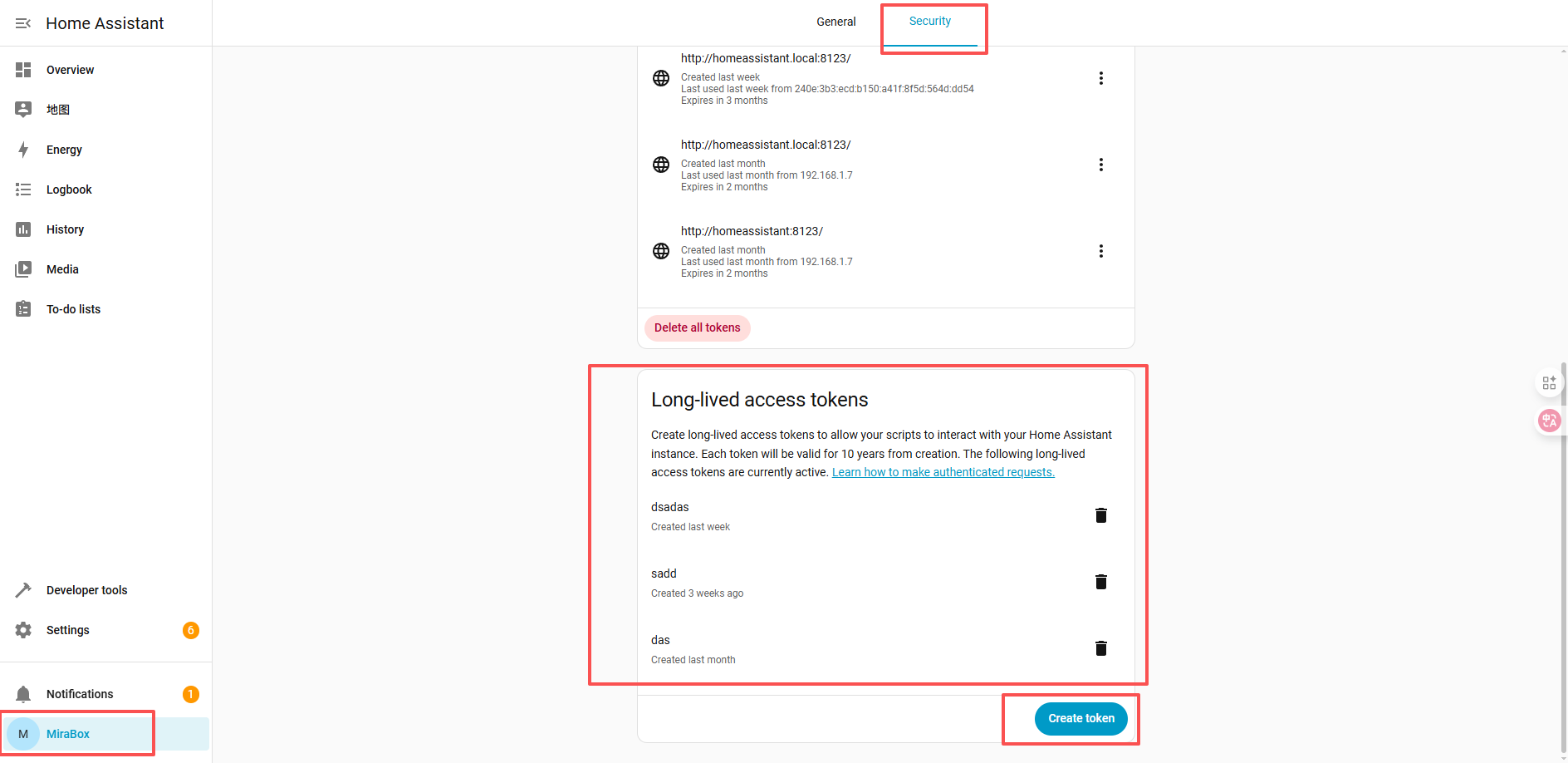

 楼主| 发表于 2025-11-20 10:09:26 | 显示全部楼层
For information on obtaining the Access-Token, please refer to:

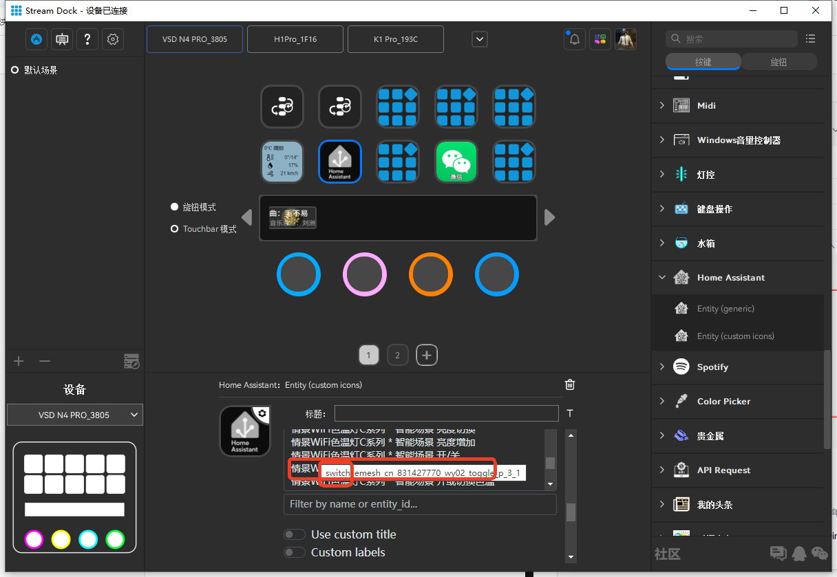

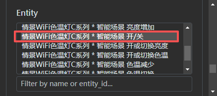

 楼主| 发表于 2025-11-20 10:10:41 | 显示全部楼层
The entity must also be selected accordingly.

 楼主| 发表于 2025-11-20 10:11:10 | 显示全部楼层
Finally, scroll to the bottom where you'll find a save button. After saving, you can control it.
